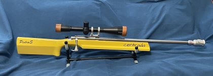

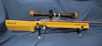

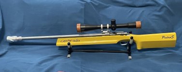

This is the rifle everyone talks about...
Tony provided me a very nice Rotex stock (in red) including a personalised end plate.
Unfortunately the Rotex is too heavy for LV weight, so I borrow the "centrada" stock, a KSS straight-line in Ferrari Modena yellow.
There's also one of my cases to show my attention to detail.
Pedro, that is one beautiful rifle! The Ferrari Modena Yellow color is fantastic! Your case does say a lot about how you approach these matches. Is that a Sightron 45X Competition scope? Did you not like the NF scope I see on the other rifle in your case?
Thanks for sharing!
The other rifle, the "centrada", is a Turbo by Calfee made for Tony Harper. The former TD. Later I bought it from Tony, but needed to fit a new barrel on it. That's a Shilen ratchet "5 match grade, fitted by Martino of GAC.
Both rifles are matched in terms of score ability. I pick one or the other depending on my feel on potential performance.
So, yes, I'm very lucky to have these two with me.
Yes, it's a Sightron 45x competition. I use either a NF or the Sightron depending of the available weight, being the NF the heavier one.
I feel the NF has the edge in optical and click authority terms, but the Sightron is also very, very nice, at half the price and available!
I tried March ones, but for some reason they don't suit me well.
Pedro, I noticed you use a front mount scope base on one rifle, and the more traditional bridge mount on the second rifle. Why do you use two different setups? Just curious...
Also, who makes the case you are using? That is a great setup.
Thanks,
Larry
Larry, I use a front scope mount on all my rifles but sporters.
The pics with a traditional mount come from Tony when he was still preparing the rifle.
The case is a Peli Air 1745. Interior foam (Sealey SF30R) cut by me.
