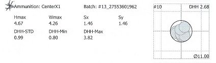

looking at this test report would this be a lot you would consider?
Thanks,
Lee

Pedro, Is this for 30 shots or 10?
several years ago, I was lucky to find a lot that did 11mm at Mesa, however it was only 10 shots.
Thanks,
Lee
Lee, that group (11mm group ammo / 5.92mm vertical spread) is for 30 shot. My best ever ammo I must say...
On your picture, I do believe DHHmax could mean max height from center to center, and being 3.82 is a very nice value.
Being only a 10 shots group, it had be confirmed by at least another 10 shots group. I've seen so many great groups just to be spoiled by the following one. So, I'll be careful considering that lot. I'm only testing with 3x10 shots groups.

DHH is distance from hit to hit.
I think something is lost in translation. DHH is the distance between subsequent shots.
Would that be the outer edge of one shot to the outer edge of a second shot?
Center to center would be a much smaller distance. It would be the diameter of the bullet difference.
TKH
That’s a good question. I ASSuMEd it was center to center for that particular measurement, but being that the group sizes are measured outside to outside I don’t know. I’m a newbie but DHH is a metric I considered since I shoot from bull to bull.
From my understanding, distance between subsequent shots, or hit to hit, have to be measure from center to center.
Lapua does metric measurements, so 3.82mm is not enough to be outer edge to outer edge, because bullet diameter is 5.60mm.
A 3.89mm CtC is for a .22lr a 9.42mm group size (outer to outer).
Or I'm totally lost...
Pedro, I believe that is correct DHH is ctc as it is being measure POI to POI
and 5.6mm is what is used here in the US for bullet diameter.
Lee
