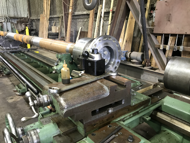

Our New Lathe Arrived This Morning.

That toolpost may weigh more than one of my lathes.
Hey Jackie...what kind of tolerances can you expect to hold on a long cut, say 24', on the new lathe?
Justin
Justin, when machining long shafts, you do the cuts in sections around 5 or 6 feet in lengths, depending on the diameter.Since it always supported by a steady rest, you adjust it to where the Lathe is cutting dead straight in that length. Then you move the steady rest, readjust and star again. Often, depending on the length of the shaft, you will often have a steady feast on each side of the carriage.
It is up to the skill of the machinist to know how to not only adjust the rest to where the Lathe is cutting straight, but also how much upward pressure to exert with the steady rest.
As a note, we never use a top on a steady rest. Here is a picture of one of men machining a Rudder post. While shorter than a prop shaft, you can see how the steady rest is used.

We put the first job in our new Lathe today.
I had to do the final straightening of the shaft and install the coupling to check for any run out. These are two 35’ 8.5 inch diameter shafts that we double end machined in one 32’ Lehman Lathe earlier before we bought this machine.
If the coupling face runs out more than .002, we take a very light skin over the face to insure it runs dead true.

Lathe
Do I understand that you run the shaft on an unturned portion of the shaft, or is it pre-turned when you get it. I would be cocerned about runout
If you look closely you should be able to see the locations of the steady rests on the pre-turned areas and I hope this helps.
Every surface of the shaft is fully machined and truly straight. The dark brown areas between the stainless steel journals , which fit nothing, have simply developed a little surface tarnish.
We are putting the fiberglass coating on the shafts now. This coating is important because it keeps the shaft from extreme corrosion in the non critical areas. Every surface outside the hull seal is either overlayed with Stainless or coated with eight layers of fiberglass.
