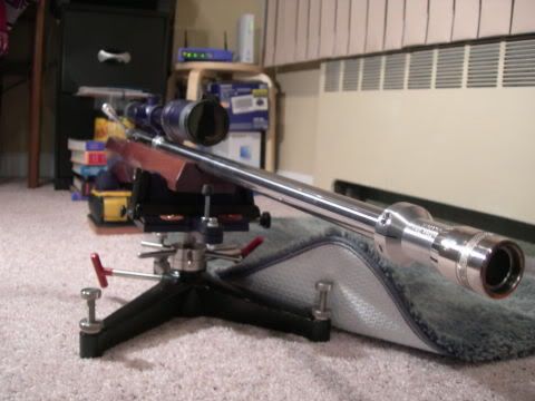

al,is that a hunter taper barrel with gene's tuner on it?thinking of doing a hunter taper on my lv so it will make weight with a tuner

using my march scope & need the smaller taper to save weight,just wonder if al's was a hunter taper so i could use the beggs tuner i already have
Yes, it is. The thread on Gene's 'standard' tuner like I used is .900X28. I heard that Gene was making them with a smaller diameter for those using Hunter tapers that wanted to tuner a bit more 'up front' than where mine is...not sure if that's true or not. maybe Gene will see this and chime in. I wanted mine back a 'ways from the muzzle, so the .900X28 worked out well.
Hope this helps. :) -Al
Here's another view of it. Sorry for the uncrisp photos. I hadn't had my second cup of Silhouwesi yet that morning. :) Jeez...that hole is big, isn't it?
"That'll never work." :eek:-Al
