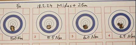

I can be considered a "wannabe" benchrest shooter, although not from my age. Below is is my problem what I have been pondering.
Fact is that all br .22 rifles have tuners so it is always part of the system.
When you start with a new rifle how do you start ?
- test the torque of action bolts (with or without tuner?), not less than 5Nm as you mentioned. Pillar bedding in wooden stock allows higher torques.
- then tune tuner ?

Hi
Thanks a lot. So, change of POI is the key.
In my Cicognani stock & Anschutz 54.30 system POI seemed to be stable and torque did matter.
I need to concentrate on this.
Well, think about shooting at 50m if possible.
25m brings a lot of distortion when measuring groups. In fact a great group at 25m could be a very bad one at 50m, and, even if it's against common sense, a not so great group close could improve at 50m, because of bullet stabilisation. This last sentence is a bit controversial but it can be seen more often than not. I started to realize this phenomena on archery. Sure, firearms do not show such a difference but it can occur.
That said, nothing better than taken measurements at intended distance...
Looking at this target I tend to say stay at 5.5Nm, but do check the bedding.
Also I prefer to shoot cards for score, than draw a line connecting centres, and be only satisfied when all bullet holes touch that line.
And completing a traget you'll get 25 shots to analyse, way better than 5 shot groups.
Rimfire ammo is, as someone else said, ammo from hell, and you can get great 5~10 shot groups, and next a real bad one. So, the more to analyse the better.
Have fun
