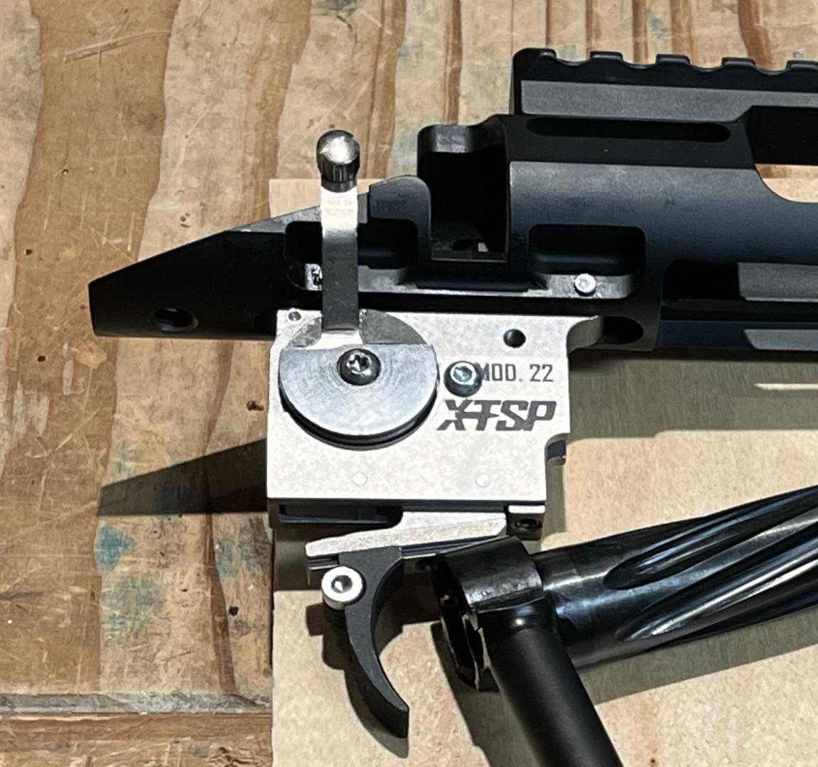

It would be a mistake to dismiss the XTSP MK22. XTSP confirms it can be set up as the same as their Kimber 82G trigger. It's all in the selection of the spring set. The shooter would have to contact them to substitute a benchrest suitable spring set.

I had a Flavio Fare on a Vudoo I had built. Liked the trigger very much, but not the workmanship on the Vudoo, which I sold on. Currently shooting primarily a KK500 with a factory trigger, a 2500X with a Jewell, a Turbo Mk 1 sporter with a B&A and a Flash Turbo also with a Jewell. I have a Kimber 82 w/the XTSP trigger and several vintage target rifles with a mix of older Anschutz, Jewell, Canjar & Kenyon triggers.
I am a serious club shooter out west with medical issues that keep me from traveling outside my local area for sanctioned matches. But I did qualify for the finals of Eley's 2023 international benchrest "postal" competition and finished 5th behind 2 Belgians, the late Johnny Montgomery, and a Brit, with a 1500-90X outdoors at 50M in November. So I am not a ARA or IR50/50 competitor, but by no means a neophyte.
In my experience I would rate the FF, KK500, and XTSP (82G) triggers essentially in a dead heat, the B&A a hair behind them, with the Jewell & Kenyons not far behind. My 82G XTSP trigger is set up for 3oz to the 1st stage wall, then an additional 0.5oz in the second stage to break the shot. Smooth, crisp & repeatable.
I brought up the XTSP in the context of the original thread premise... with Jewell gone are there any American made alternatives of similar quality? XTSP is not well known in smallbore circles, beyond those intent on improving the performance of a Kimber 82G. However, its owner, Tom Myers, is a competitive shooter, and XTSP is the OEM trigger supplier for Accuracy International's rifles, including its GI sniper rifles. His triggers generally run about $100 less than any of the imports. I would never suggest that anyone swap out a trigger they are used to and comfortable with, but if a replacing a Jewell, or selecting a trigger for a new build is in the offing, I would suggest contacting Tom Myers at XTSP to explore the options with his Model 22 target trigger.
