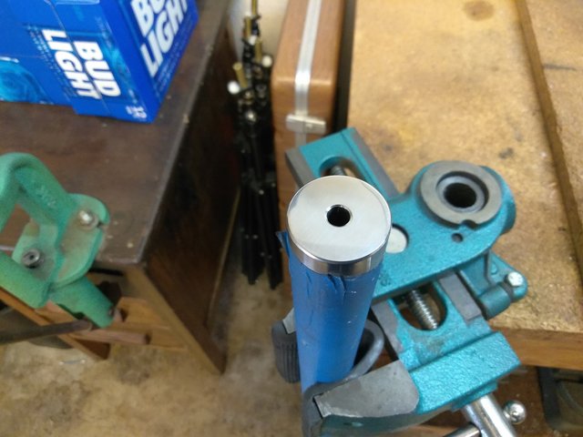

carbide insert made for aluminum on a boring bar for my cone and crown at about 1200rpm. No burrs and a mirror finish with a little viper's venom
Crown cut with HSS and polished for cast bullet benchrest use. Polishing is required to be able see the lube star left on the face of the muzzle.
