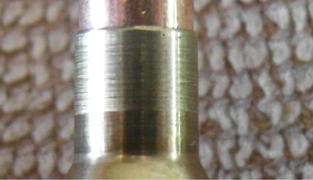

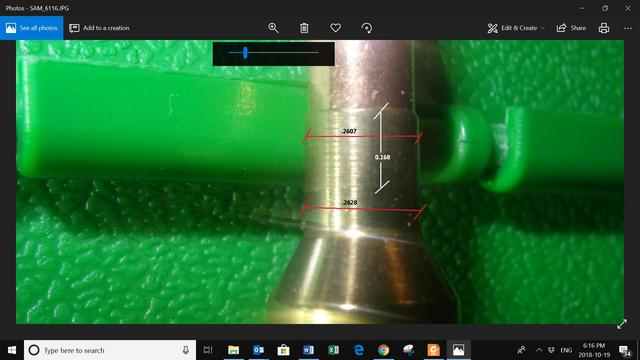

The loaded round that came with the rifle seems to be neck turned for 2 different thickness:
The last section of the neck is thinner that the section closer to the shoulder.
The section near the mouth is on average 0.2607 thick, (around 0.168 long)
The one closer to the shoulder is 0.2628 thick . not the safest maybe….
"yes I will buy the outside neck turning attachment for my Forster case trimmer and turn the neck to be safe."
i hope someone will jump in with suggestions, but there are better choices.
I don't think the neck is turned to two different diameters.
It's common for button style sizing dies to leave a small part of the lower case neck unsized....in essence, the lower portion is what the chambers neck diameter measures.
you could be right !
( I thought I could see very weak tooling marks at the base of the neck, but it's not obvious....)
thanks
The upside to the lower case neck being unsized is that you now know what your chamber neck diameter is.....at least withing a few .0001's (ten thousandths).
The general feeling is that the unsized portion, since it's basically a 'gauge fit', helps align the bullet with the throat. -Al

Here you go.
that case is not turned into the shoulder enough to prevent a doughnut. There is a fine line between a doughnut and having the neck seperate from the case because it's to thin.
Richard
Richard
You have to go onto the shoulder with a cutter set to the correct angle to prevent the donut.
That is why cutters come in different angles to match case angles.
I never knew why folks turned cases into the shoulder to prevent a donut. I just turned the neck all the way to the bottom and let it go at that. I understand that the donut becomes a problem if it contacts the bullet but never had it happen if the necks were turned to the shoulder. What's the perceived problem if you have a donut below the bullet?
I'm getting a PMA cutter with a 30 degree angle fyi....I was told it will take care of donuts issues
not saying the case above has one.... just saying what's on my buying list
