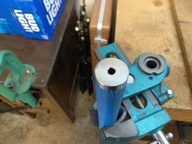

    You would probably better served to chuck it back up in a lathe and using a four jaw chuck dial it into as close as you can to zero run-out at both ends. Face it off then do about a 30 degree cut while backing the cutter out to just beyond the depth of the bottom of the grooves. And then polish the face of the muzzle so you can then actually see the lube star left on its face to see if it is was actually done correct. I too am a competitive cast bullet shooter but in a slightly different sport and it being competitive benchrest shooting at 200 yards. Below is a picture if how I crown my own and also a few for friends that has been working out very well over the years for all of us. Not saying it is the best way but only that it is my own way as there are many ways to skin a cat.

    Quote Originally Posted by Louis.J View Post
    Are you SURE you're Kalifornian???? Bud Lite?? I'm not a beer man but I've always understood it's Coors over 2000ft and White Claw down on the bi'ches

    " Are you SURE you're Kalifornian???? Bud Lite?? I'm not a beer man but I've always understood it's Coors over 2000ft and White Claw down on the bi'ches ".
    Who knows after one to many I tend to loose track of where I am actually at? But thank goodness the crown has already been done prior too that time?
