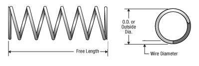

Can someone please furnish me with a source for plunger type ejector springs that are used in most custom actions. I would like to buy a small amount to have on hand..

Pete, I use lengths of spring stock from McMaster-Carr. PM me you mailing info and I'll drop a length of it in the mail.
The spring from a disposable lighter, cut down, works great.
Supposedly they work as replacement sear springs in Remington triggers also. I tried selling 3 new Remington springs and someone replied that the springs from BIC lighters would work. Springs and other Remington parts [esp left hand] are hard to find unless you want to pay thru the nose at Numrich. A place called erniethegunsmith.com in AZ has new springs.
